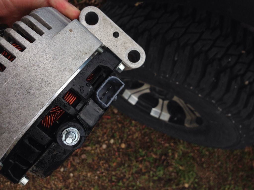

My alternator is not working, my brand new one isn't either. So obviously it is not wired up right, I believe it is not getting activated. I am confused and I think I will end up building my own harness from scratch, so lets go back to the basics. Here is a picture of the alternator:
Ok so the stud is where the power comes out (correct? Please tell me I at least got that right) so that goes back to the battery (or the top of the starter solenoid)
The whole case is grounded correct? It gets bolted to the block which should also be grounded to the frame (battery negative, block, and frame should all be connected right?
Ok and then there is the plug. There appears to be three conductors but the harness I have on there now (which may be wrong keep in mind) on has a plug with two wires coming out of it. Is one of those conductors not needed?
Right now I have a spare plug that has two wires going into it and one of the wires has a diode on it...whats that all about??! There are other wires in the current harness but I think they had to do with a remote starter and whatnot.

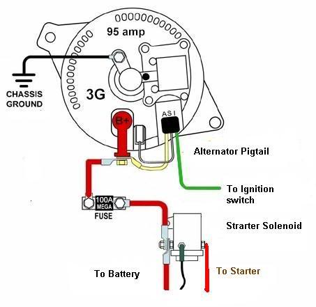

I just bought a 1 wire alternator. alternator to battery. done lol

is this right?
Right on. I can try that setup. I didn't know there was a mega fuse? Also the ignition switch wire...is that like a 12V switched? (only 12v when the ignition is turned on?)
8,369
Yes, the "I" wire usually comes from the Battery Light/voltage meter circuit, it is the ON/OFF switch for the alternator.
Usually the Light Green wire on the 3 wire connector.
An alternator is an electric motor used in reverse, if left ON it would drain the battery trying to turn the engine, lol.
When you turn on the key the voltmeter/battery light circuit gets 12volts, the "I" on the alternator "acts" as a Ground since alternator is not turning(producing voltage) so with 12volts on one side and "ground" on the other side the Battery Light Bulb comes on.
When you start the engine the alternator starts producing voltage so the Battery light now has 12volts on one side and 12volts on the other, so Bulb goes out/off.
This 12volts also powers voltage regulator circuit which powers the alternator so without the 12volts at "I" alternator is OFF, so it won't drain any power via the big B+ wire(large stud)

AH that makes sense. So...my harness has two wires and the alternator had three studs. Is the S optional?

"A" and "I" are used on the 5.0l engine harness, "S" is not.
Light Green wire for "I"
Yellow for "A", it runs to a mini fuse in power box, fuse #6 in my '97 explorer diagram

Calling the locking tab up, my yellow wire is to the right and the green wire is to the left. Yes, green is hot with key and yellow with battery.

Hmm, well the fuses mentioned by RonD are both good. The plug is wired correctly. The yellow wire gets battery voltage (almost) all the time, but the green and red wire gets 0.00v while the truck is running. So I think I found my problem. Which would also explain why I can't remember seeing the battery light...dangit. So if it isn't the fuse is there anything else I could look for? I followed it back to the plug by the ABS module and then it disappears into electrical land

Yes, the green wire is the ON/OFF switch for voltage regulator/alternator.
