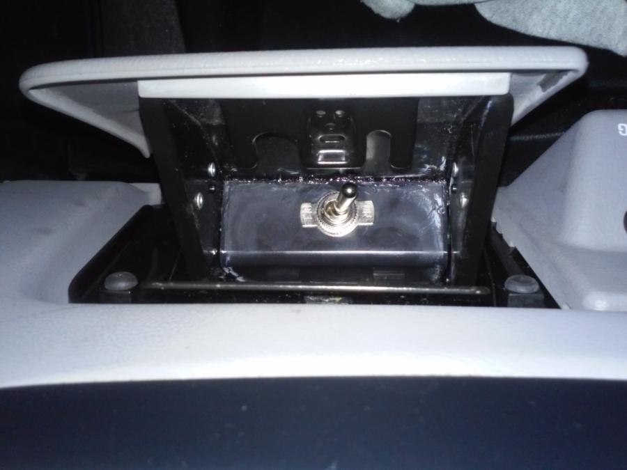

I took your advice and found the fuel pump relay ground lead coming out of the power distribution box and to the PCM. Conveniently, this is one of the outer most wires in the section where the wire bundle feeds the box. The FP relay sits right above the bundle and the wire is blue with orange striping.
I fed my new leads over the brake drum and through what I believe to be a steering column grommet/boot. I've read a lot of people use this section to feed wires through the fire wall. I added some heat shielding on the part of the wire closest to the engine. From there I setup an ashtray switch and am good to go.
I do kinda wish I had a less obvious spot but this will do for now.
I tested it and it wouldn't turn over while the check engine light came on, just as you stated.
