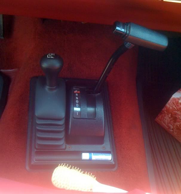

Basically, I'm considering doing an explorer 4.0 swap into my 88 Bronco II.
I've done a fair bit of research, and it seems everyone is split on whether the A4LD can handle the increased torque or not. If it can, fantastic; case closed, I'll keep my A4LD and my fancy floor shifter. If it can't, then my question is:
Can the 4R44E or 4R55E transmissions be swapped into it without the loss of my current floor shifter?
I know it seems silly, but I've never personally seen another BII with one, and I love it.
I appreciate any and all advice you can offer, and thanks for your help!

The later A4LD should handle the power about as well as it handles anything else. It can be used with the floor shifter, but you have to use factory manifolds and y-pipe. There are no 4.0 headers that I have found that don't interfere with the shifter linkage on the floor-shifted units.
And for the record, all RBVs with auto trans were floor shifter from 83 to 88. 89 was the first year they ever used a column shifter.

Thanks for all the info! I hadn't seen a floor shifter automatic before mine, so I guess I just assumed they were uncommon!
Now when you say later A4LD, what year does that start? That will give me a good idea of what year Explorers to look at for the swap.
For the issue with Exhaust clearance, is it a matter of not enough room overall, or would I be able to fabricate headers to fit without interfering with the linkage?
Thanks again!

My red 87 had a set of pacesetters on the engine when I bought the truck. The outlet of the LH header of right on the cross-over pivot bar, to the point where the pipe bolted to it would have to be flattened and make a hard 90 to fit. I have not seen shorter headers for the 4.0.
