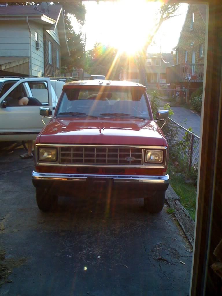

So, I'm going to finally start my build thread:headbang:

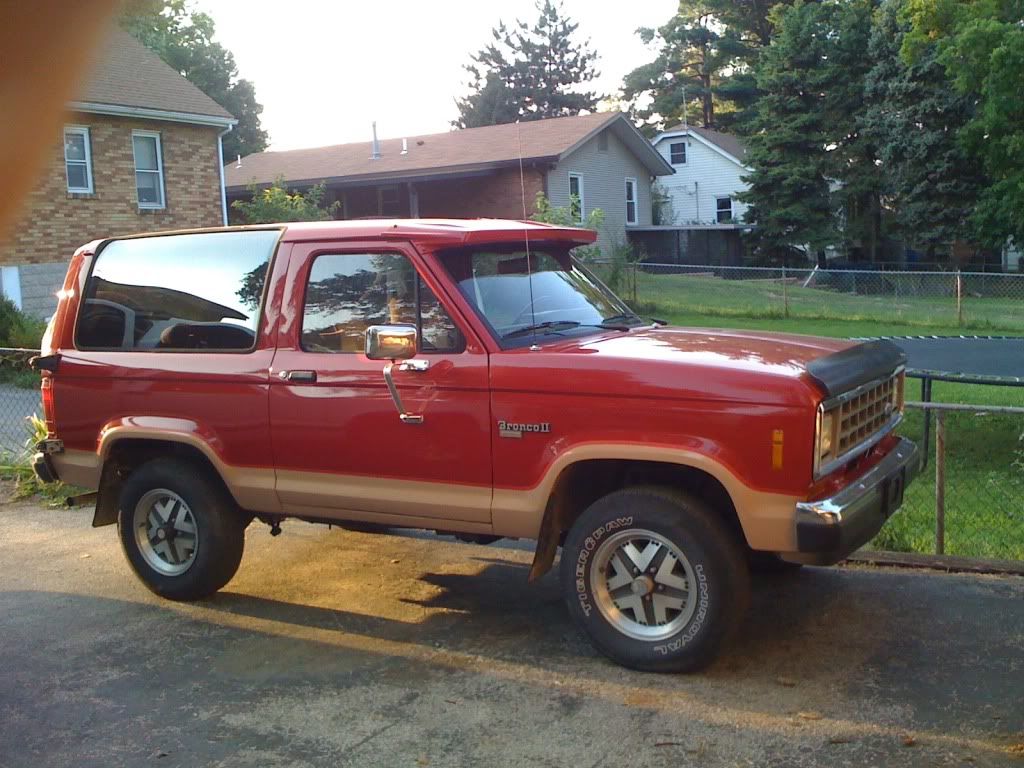

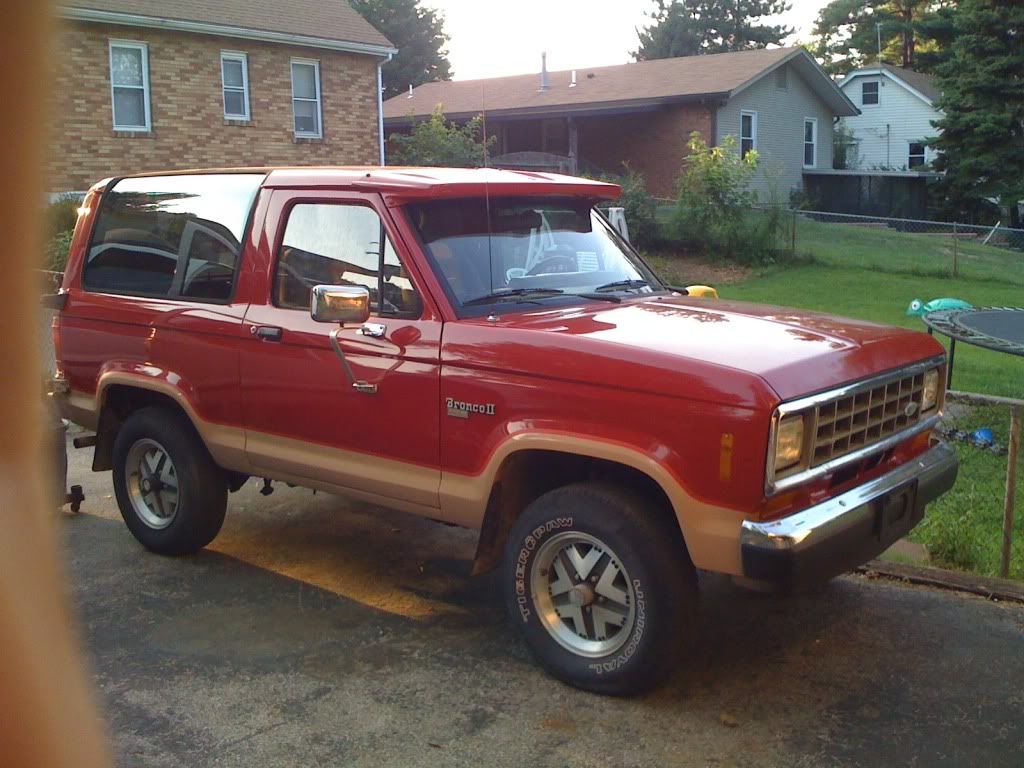

This is my BII the day I picked it up.
I picked her up for $1,300 with 113,000 miles and brand new paint. Plans are to do a 4" suspension lift with 31s then later on do a Dana 35 and 8.8 swap with some 4.56 gears front and rear, and a lock right in the rear as well.

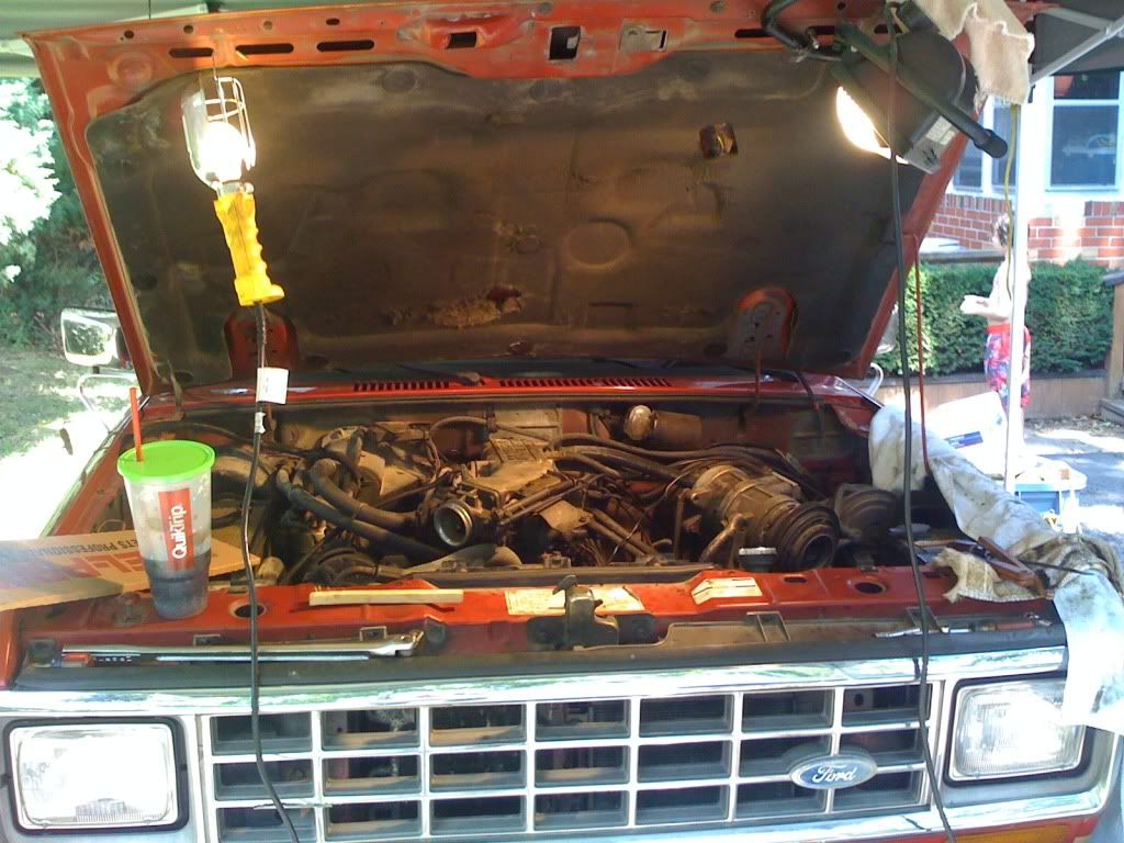

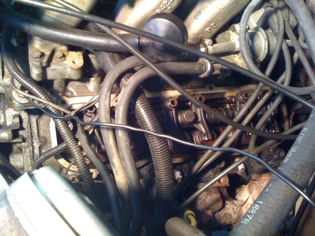

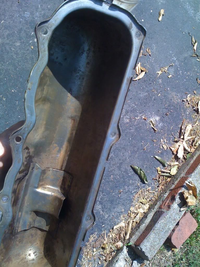

First thing I did was replace the old valve cover gaskets, the old ones leaked real bad.
Cleaned the valve covers up a bit
I also did a full tune up, this thing runs great:icon_hornsup:

damn, that's one slick b2 you got there. great deal too, $1300 for an EB with 113K, NICE!!
there are people around here that list crappy b2's with 175k for over $2,000.
this thing is gonna look good lifted

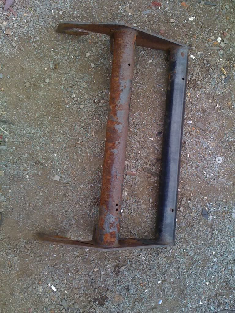

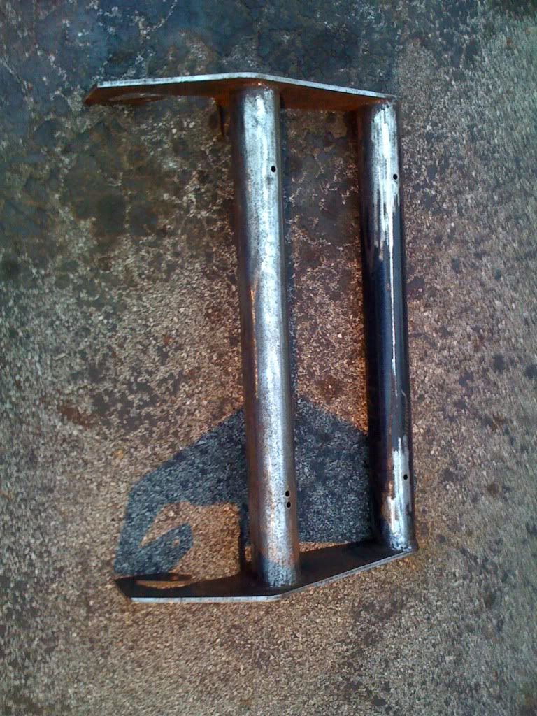

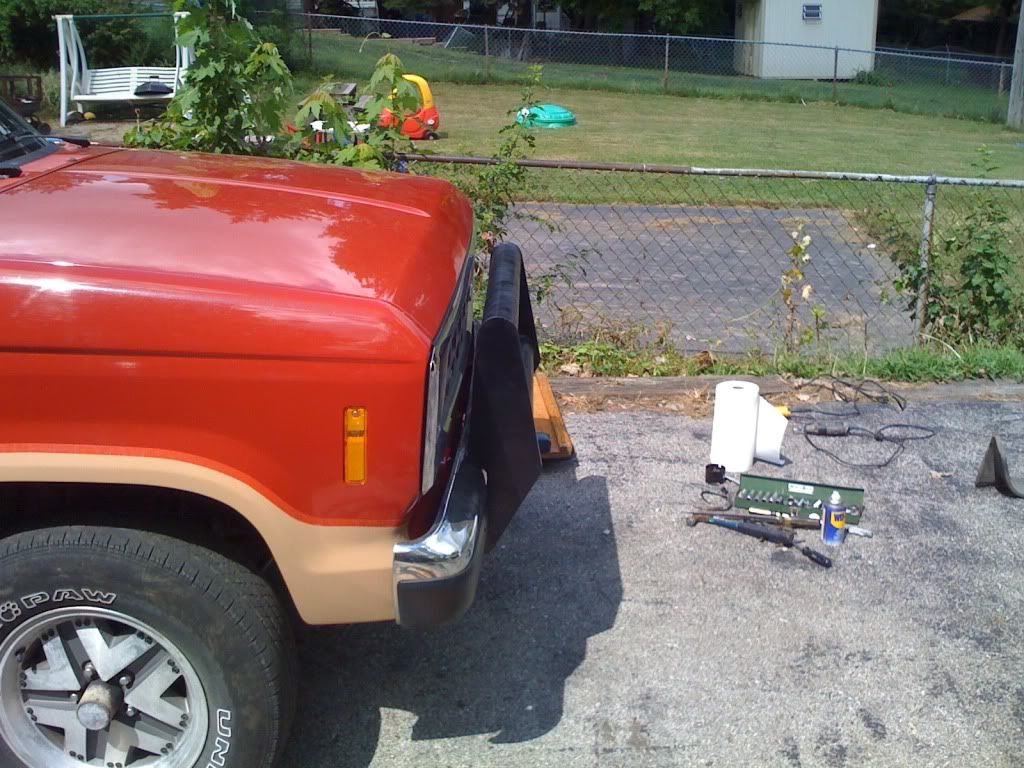

A little while ago I wen to the JY to see what they had for the BII. I found a brush guard and new seat mount that I thought would be cool to have.
This is the brush guard off an 86 ranger, picked it up for $40:headbang:
Got it cleaned off and painted
Mounted on the BII

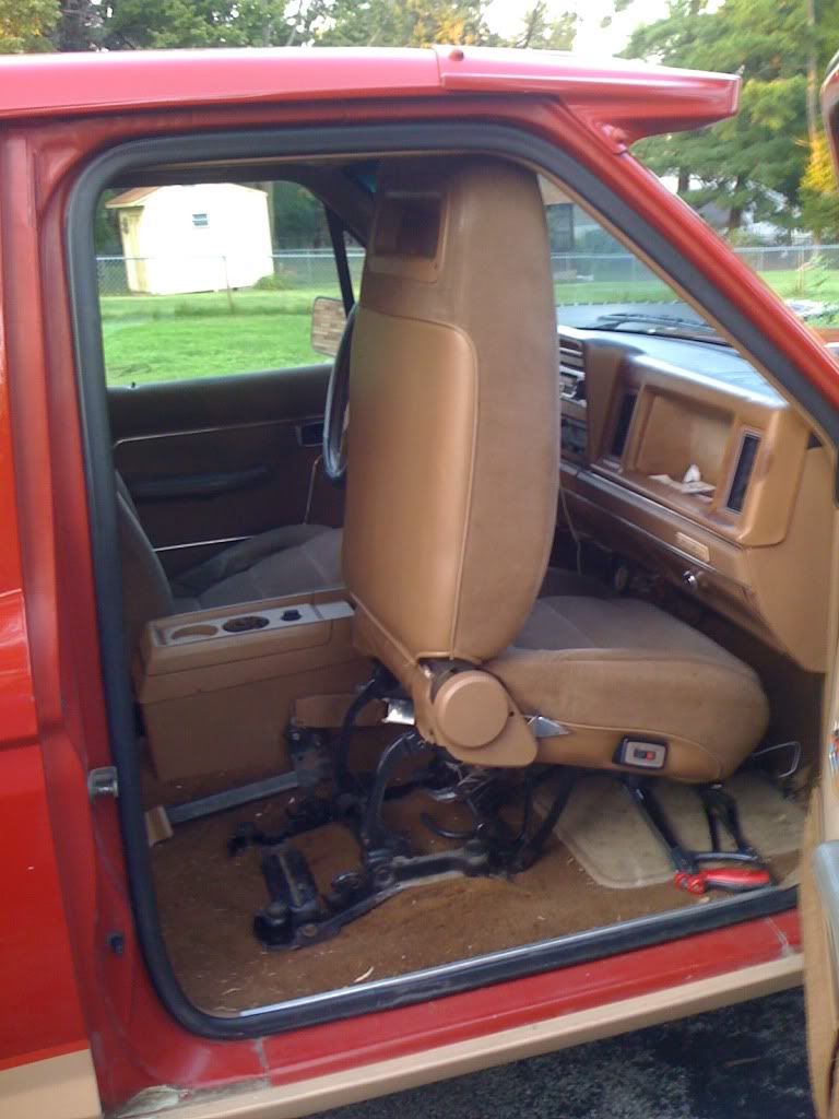

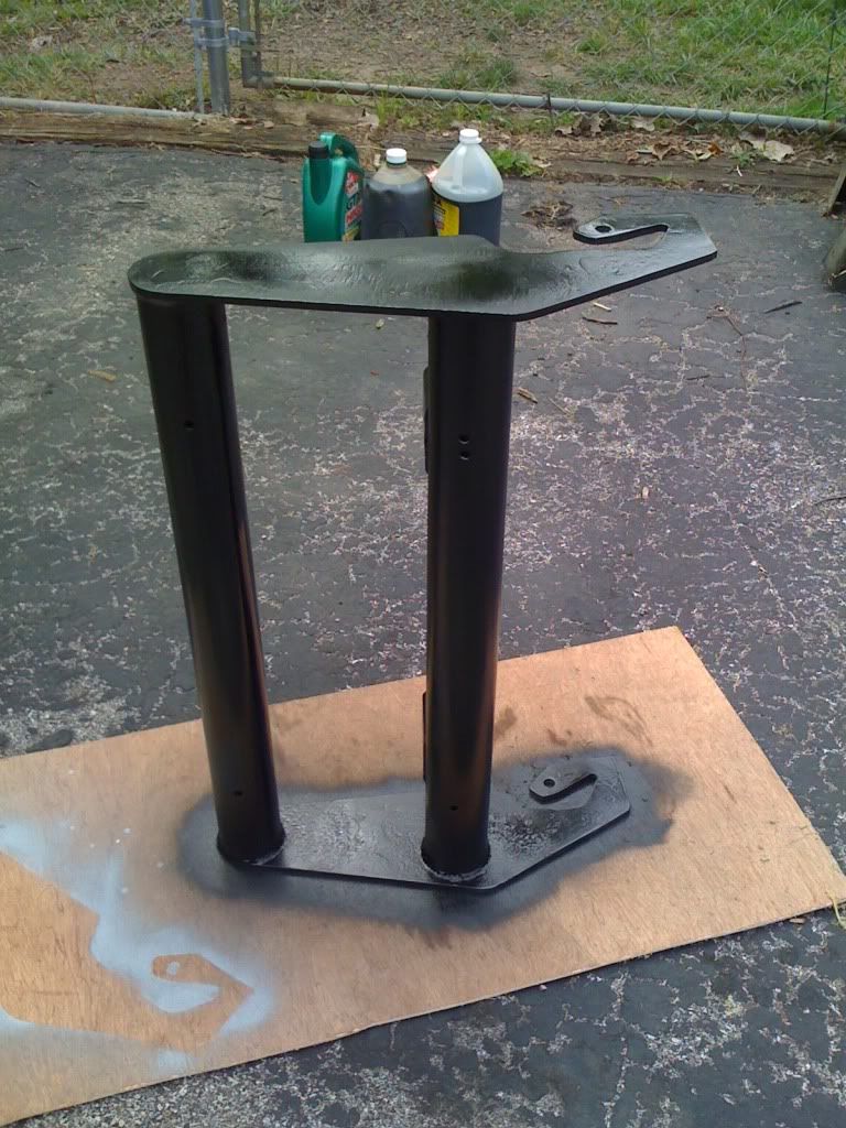

Here is the new seat mount. I just thought it was cool.
Makes it easier for people to get in and out of the back

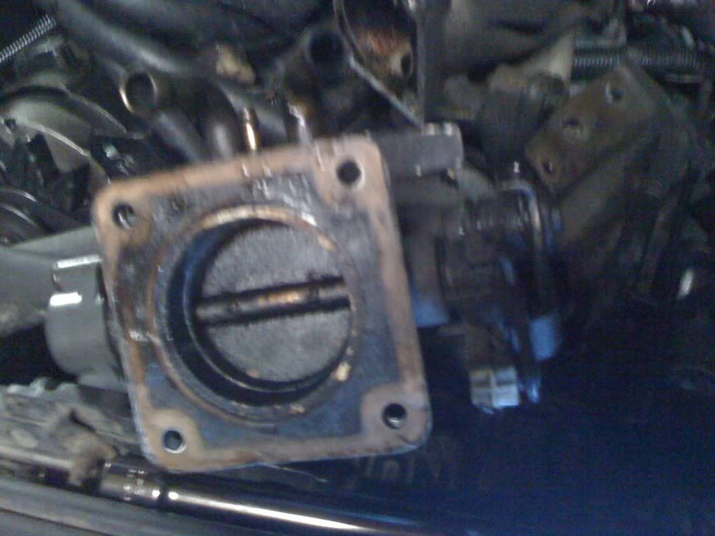

Also did some cleaning under the hood. the throttle body was in rough shape.
BEFORE
AFTER
Nice and clean now!!

Speaking of throttle bodies, I think theres a write-up in the Tech Library on how to put a 5.0 throttle body on a 2.9, dont know what it all takes to do that, but should help with performance.
Have to say thats one of the better BII I have seen.
88Bronco2EB
Oct 9, 2009
110
thanks man, I thought about putting an 86 or 87 throttle body on. They are larger then the 88 and up 2.9s but I decided to keep it stock under the hood for now anyway. lol

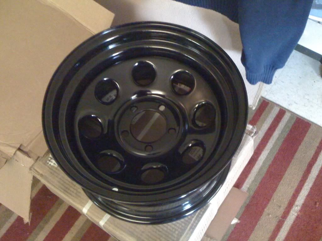

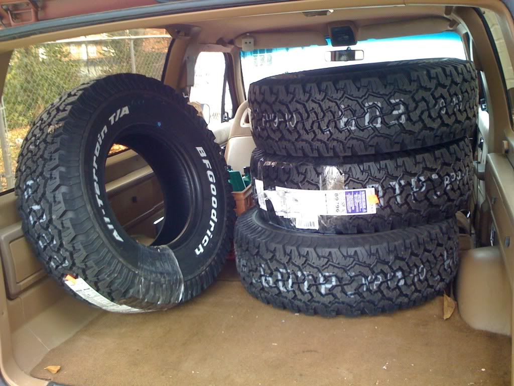

So here are the wheels and tires I bought back in December. 31" BFG All Terrains on some black powder coated 8" Crager wheels. Saw a BII on here with this wheel and tire combo and fell in love with the way they look on a BII!!
TIRES
WHEELS
Then I had my buddy mount and balance them at his work for FREE:icon_hornsup:

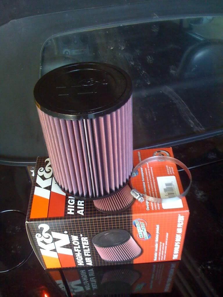

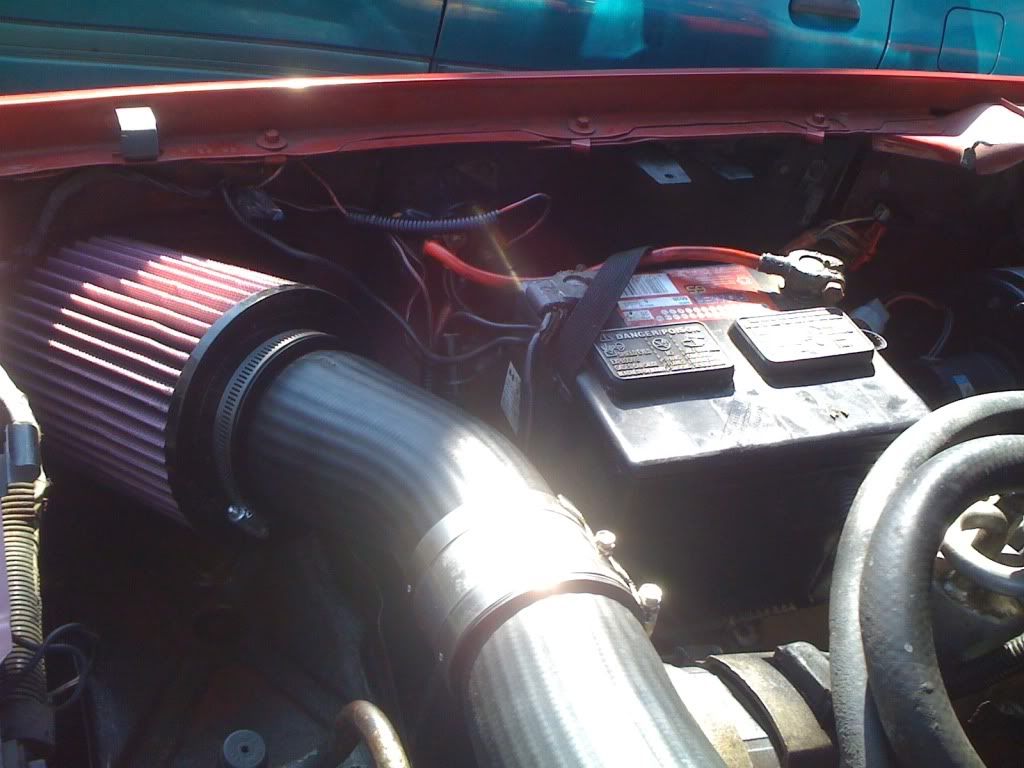

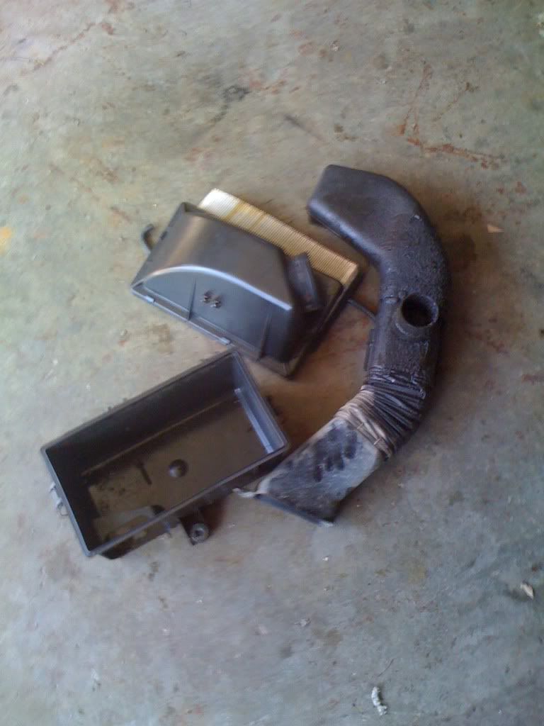

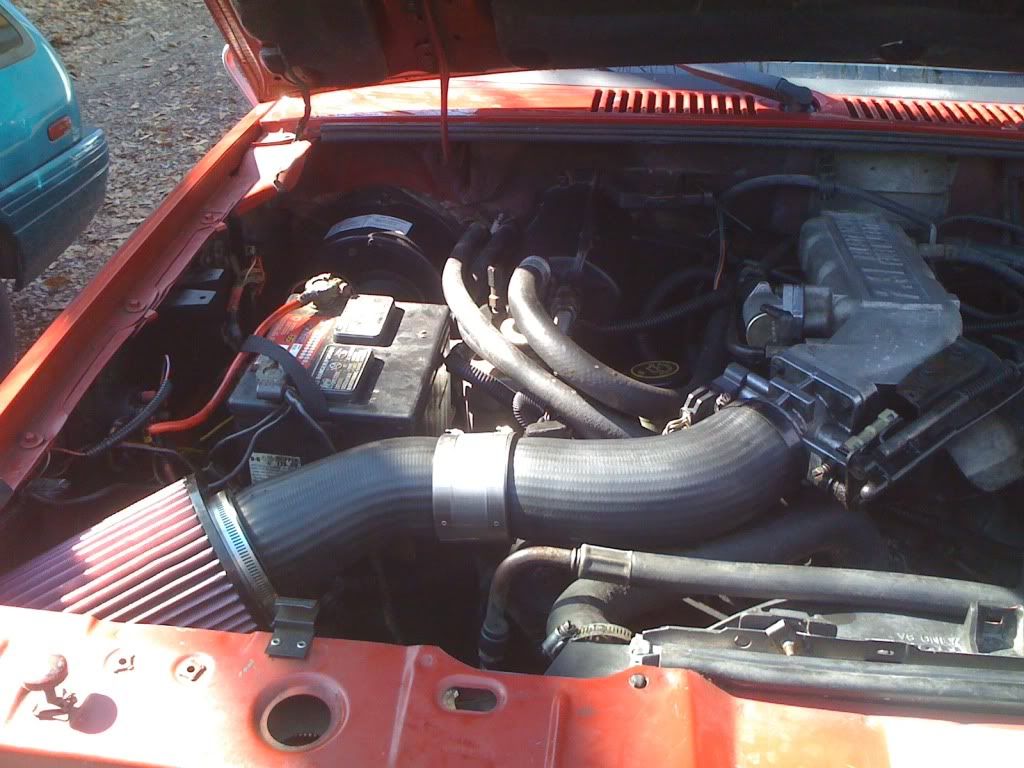

Picked up a K&N air filter and stock it on. It flowed a lot better and sounded mean when you step on it, but for now I took it off until I can make some kind of heat shield around it. That way I'm nut sucking in hot air!
All the stock air box components the K&N replaced
I hacked the intake tube and swapped locations with the battery
Like I said I'll put it back on when I build a heat shield for it... someday

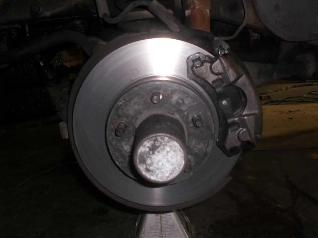

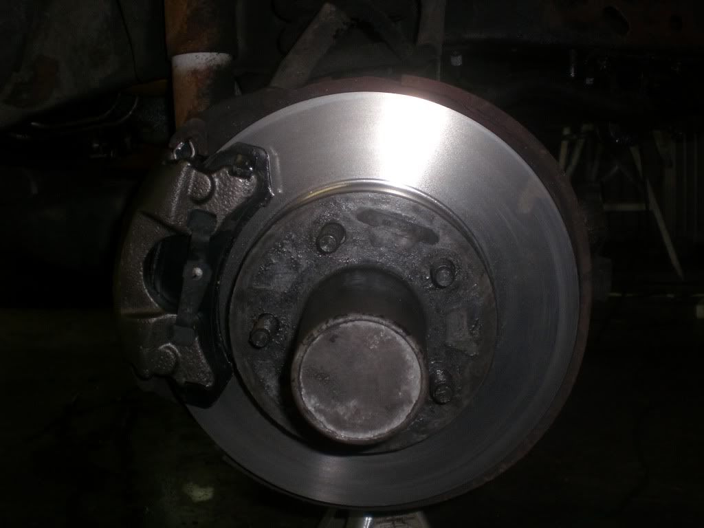

A couple weeks ago the right front brake caliper locked up on my when I was on my way to go camping:annoyed:
So I took this opportunity to get all brand new brakes:headbang:
My buddy that mounted and balanced my tires hooked me up again with all new brake pads, rotors, and calipers for both sides for $150:icon_hornsup:

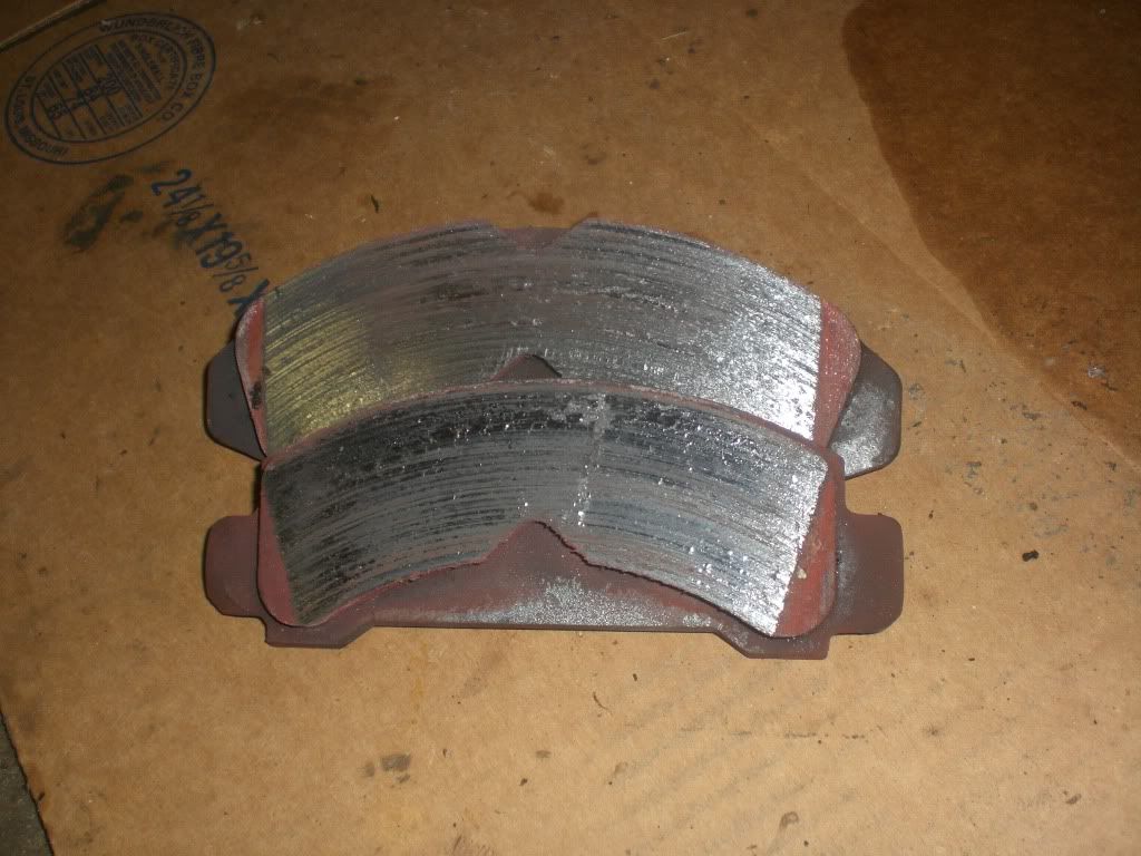

Here are the old roasted pads, see the cracks?? lol
Now the new brakes!
oh, and the booster also went out when I tried to drive home with the brake locked up so I replaced that too.
Old booster
I went ahead and replaced the master cylinder too because it looked nasty on the inside.
and here is the old locked up caliper

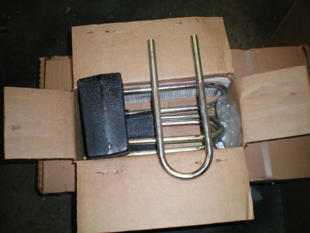

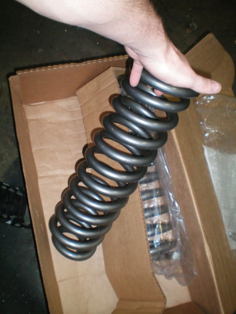

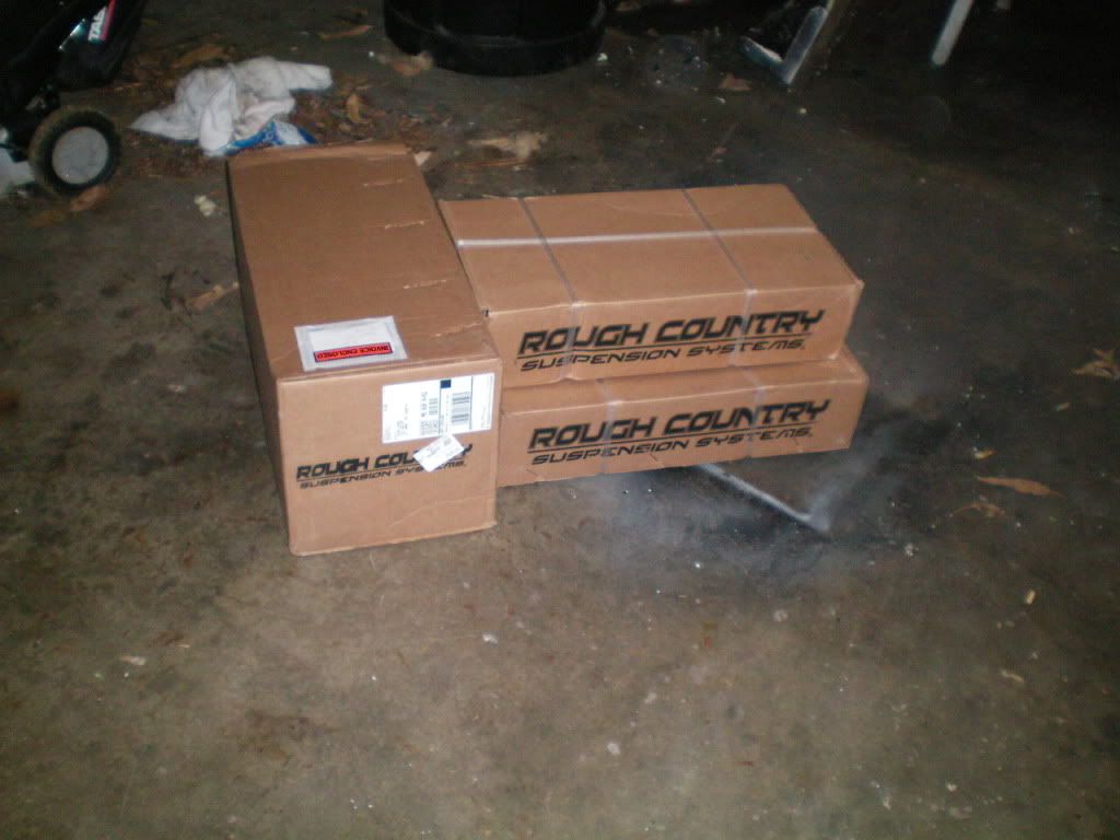

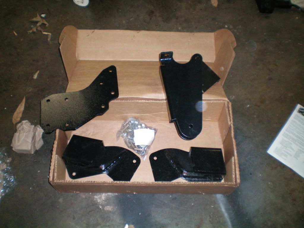

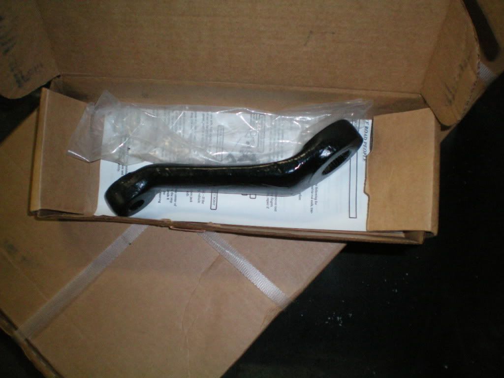

Some presents from UPS:headbang:
My 4" Rough Country lift kit. I know its not the best but its good enough for now.
http://www.therangerstation.com/forums/newreply.php?do=newreply&noquote=1&p=765348
Drop pitman arm
4" lift blocks
Sway bar drop brackets
Nitro 9000 shocks
Coil Springs(I think I will paint these red)
Axle drop brackets and radius arm drop brackets

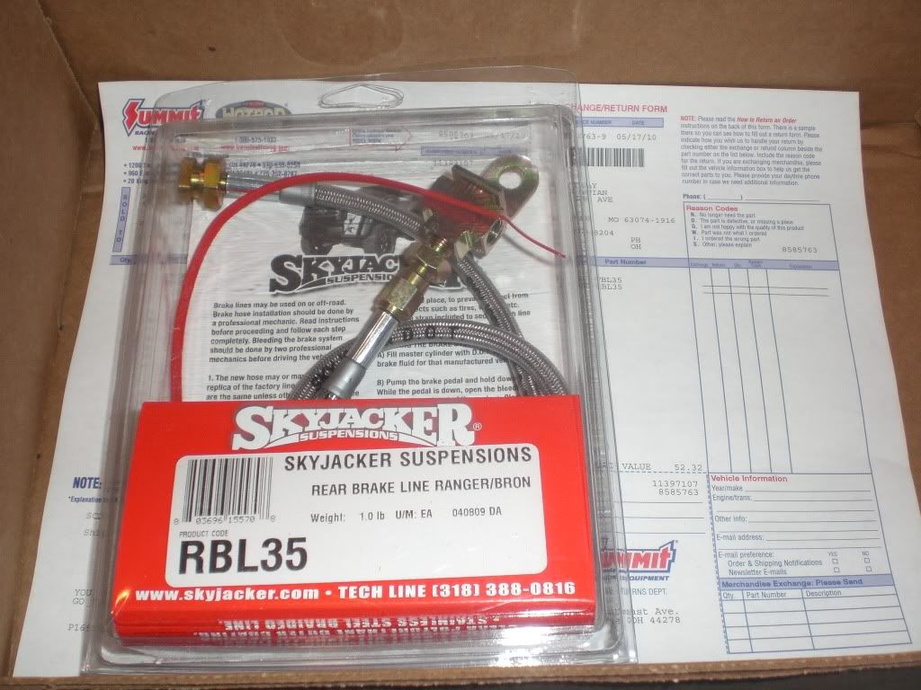

Also got some front and rear skyjacker stainless steel extended brake lines
