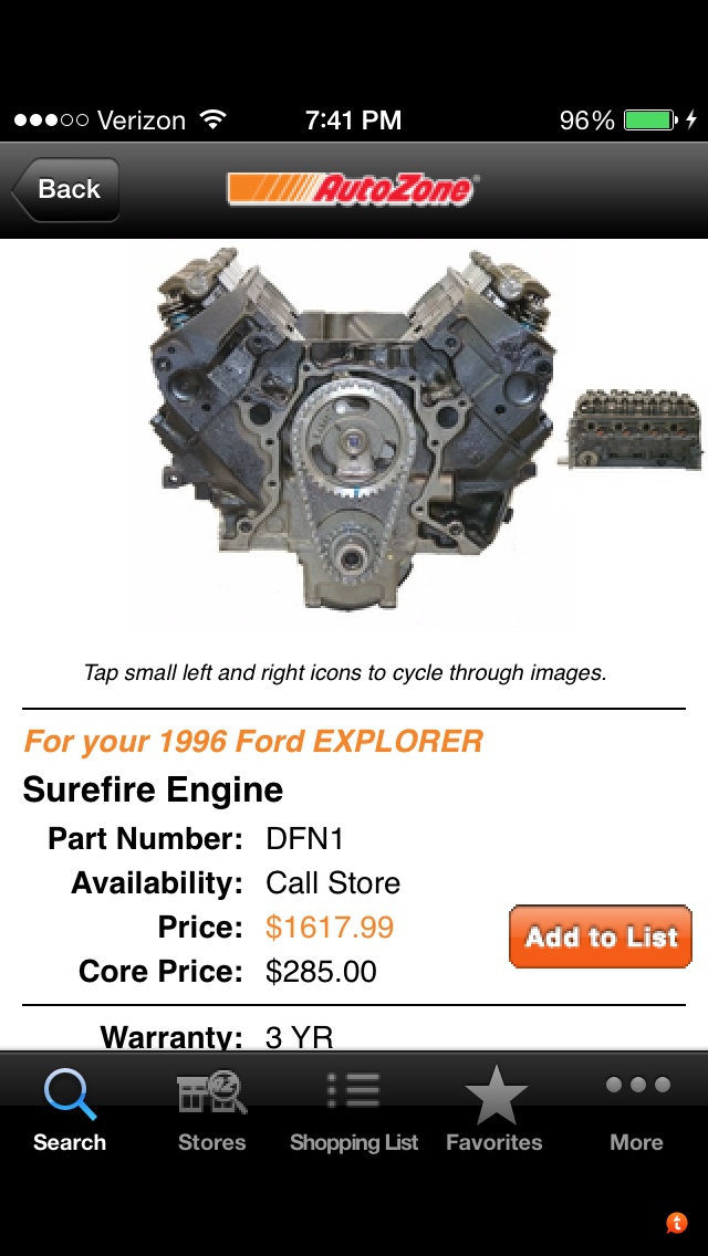

No way I'd pay 8500 for a V6 when a V8 is this cheap!
Buy a exploder as a donor then buy a reman long block, swap everything over and you'll be runnin in no time!
