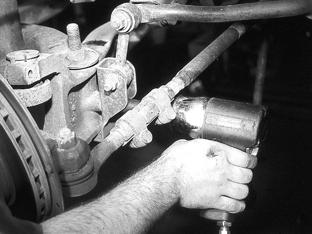

Hello all! I’ve got a 1990 Ford Ranger w/ 351W and T5. I’ve bought all new components to freshen and lower my truck’s suspension. I also wanted to make it handle better, so I purchased a front and rear sway bar kit from Belltech. Trouble is, this kit assumes that I’ve already got a sway bar up front. My truck never had one and is missing the bracket required for mounting. The bracket in question mounts to the I-beam and can be seen in the attached picture. Anyone know where I can find one of these new/used? LMC Truck offers the one for 4wd, but nothing for 2wd. Any help would be much appreciated. -Nick

No ideas for purchasing here, sorry. How about making a pair? Looks like pretty simple fab work.

That will be the alternative, just trying off the shelf options first. I've made a bit of progress by finding the part number, it's F0TZ-5486-A. The hunt is on!
