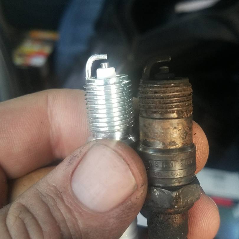

Sofar I've changed with Kraken spawned ink oil that was sitting in it with high mileage synthetic (167k on engine 277k on chassis) as well as a quart of Marvel Mystery (considering using lucas next change). Seafoam in the crank before the change, as well as in the gas tank. New basic ngk plugs, basic spark plug wires and rebuilt distro. New idle air control valve as well.

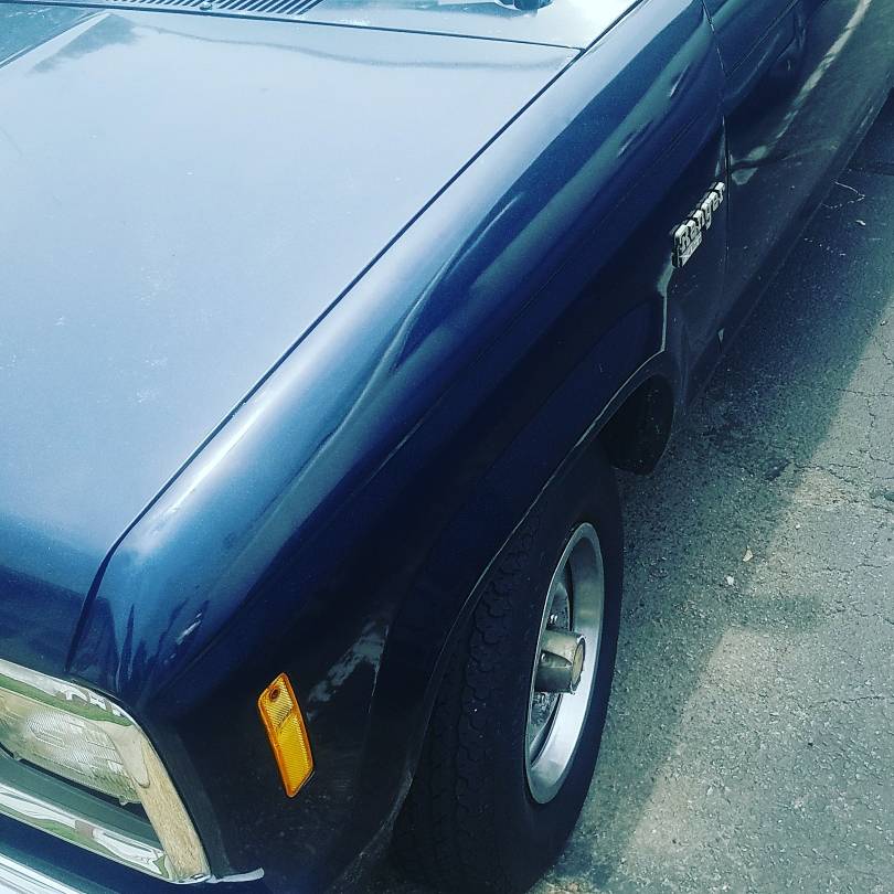

That is nice and clean. I'm not sure I'd change a thing on it, except that garbage oil filter on the front seat.
