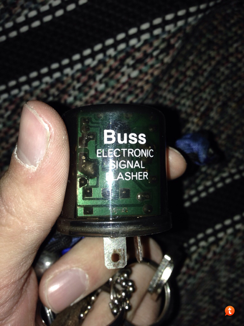

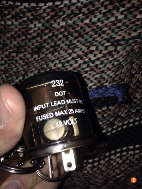

Here is what I got, don't have the link anymore

Went to Oreilly today and picked up that exact flasher. It fixed the turn signals not working. Still at a loss on why the turn signal lights up the other side. Decided to try some separate turn signal fixtures. I picked up some 2" round amber lights. Tried to wore them in skipping the trailer adapter all together. Now when I turned on the head lights the tail lights work till you tap the the brakes. Once the brake lights are turned on they stay on till the headlights are turned off.
