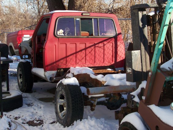

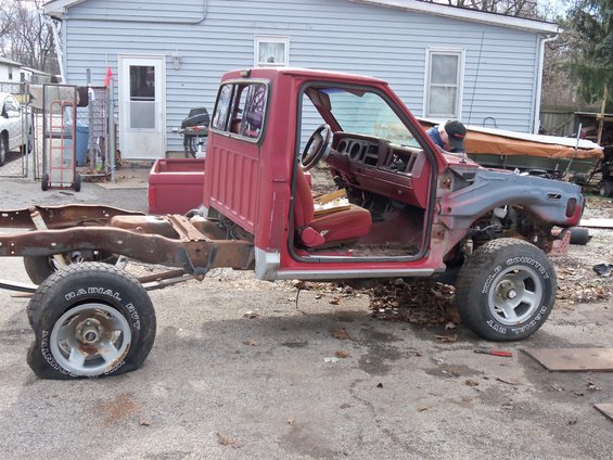

I have officially started my (and my wifes) Ranger Rebuild here is the General plan:
1. It will be Red
2. It will be 4x4
3. It will stronger than before
4. It will an automatic (probably)
This is part of the before picture the cab that will be on it is not this one.

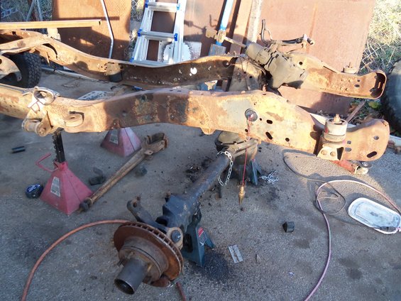

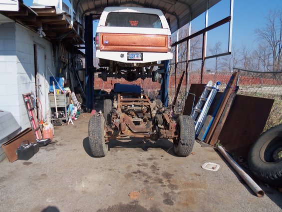

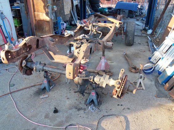

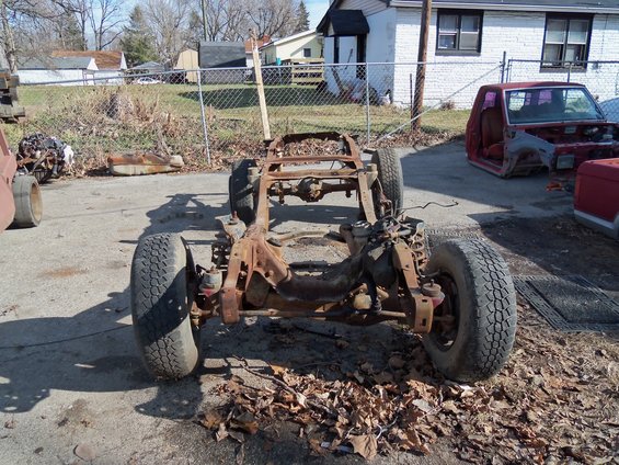

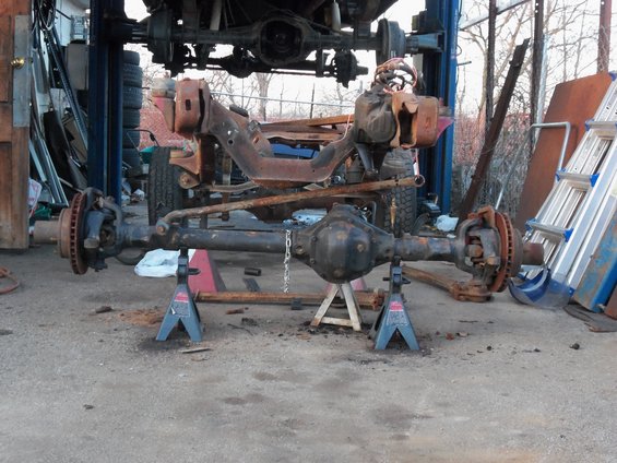

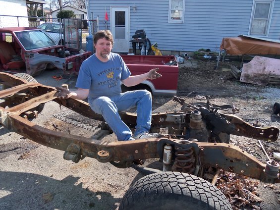

Finally started the teardown process cab, bed, and driveline alll got pullled out.
There's always one bolt that won't come out normally
Fork lifts are very handy I recommend one if you have the means.
Awesome high angle driveshaft
Man these frames are flexy but not for long
This is the only picture I have of my truck as I remember it back in 92'
Day two begins the front end work

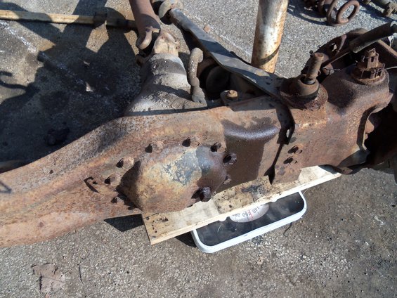

Ever wonder how much a Dana 28 weighs
Mach up time
leveled it up a little
Long radius arms on the front. Got a piece of 3"x1 1/2" 11ga rectangle tube and heim adapters from Ballistic Fab

its hard to tell but i think id move that front end up some still looks like the difs behind the engine crossmember. strech it out so its in front of the crossmember then you get more uptravel without being real high and its a better approatch angle.

That is the plan to move the axle forward a touch. As for the engine cross member I want to rethink it also. I was never a fan of that monstrosity I would like to do something along the lines where the oilpan can be serviced without a engine host and some choice words.
The rear suspension I am going to use will be more along the line of the desert runner 4 link that giant motorsports makes only home built and modified for trail use. I am having very serious thought about air suspension and will experiment with it to begin with leaving the ability to switch back to coil overs or regular coils if plan "A" fails.
Brayd on here has the setup I like real well I want mine to work very similar to his with a few extras that make it mine.
