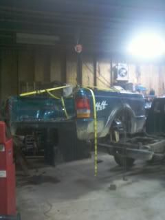

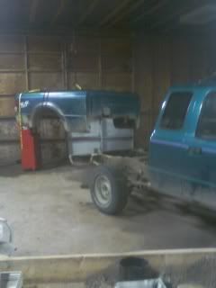

its a T55 torx head on 6 bolts, then the tail light plug in and the filler neck needs to be unscrewed. i removed mine myself a couple times but now i have this rigged up:
Help with removing bed of 1995 mazda b2300
