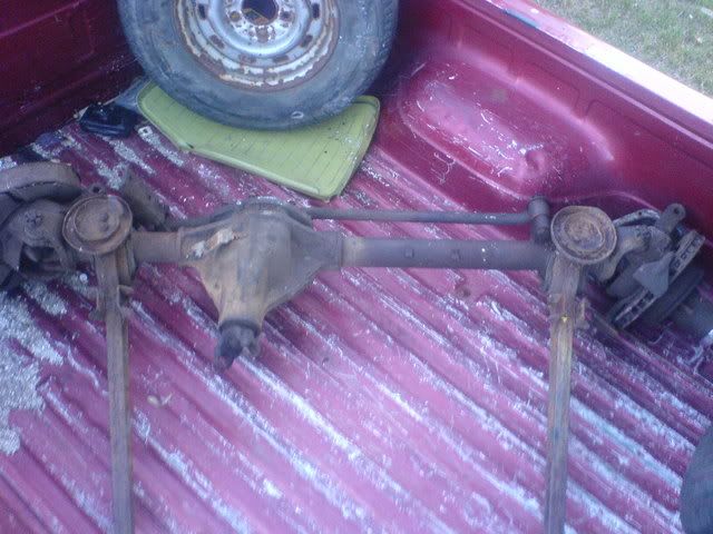

Origonally for the 4x4 conversion i was going to use a stock setup and swap crossmembers. I even bought a parts explorer for this, but the guy i bought the explorer off of threw in a FREE dana 44 front axel. So now i had both options, so im now going with the dana 44 and i have to re-weld and bolt the origonal crossmember back on. oopsy.

Yea its a D44, but I want to narrow it bout 6" to get it back to about the stock width.
I know that i SHOULD leave it the way it is to compensate the high centre of gravity, but i really dont like the look of a full width on a ranger, way too much wheel stickout.
I have the axle damn near ready to start cutting, but i need theres a lil bit of info i need. I was told on the old forum that if i cut 6" off of the (drivers or passengers side) of the axle that it would be a stock replacement axel shaft from something else for if it ever breaks. I need to know what that vehicle it is that would have that length of axle shaft? And if im corrent on the 6".

I don't know exactly what length, but check either early bronco or wagoneer axle length, wagoneer being 2-3 inches wider then stock, but narrower than fullwidth.

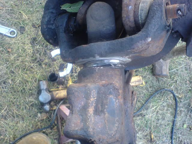

Its hard to cut the weld holding the end of the tube without cutting too much, takes a lil while. I was 1 grinder cutoff wheel width away the first time.
My backyard build (56K warning)
I tried to take the hub and the rotor and all the stuff off the end of the axle and decided it was too much like work after getting the ball-joint nut off.
