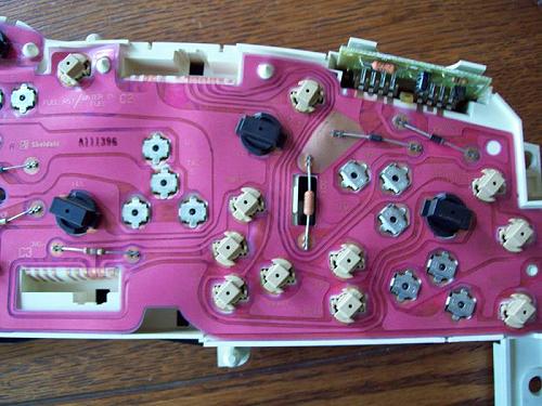

Anyway, I need an ANTI SLOSH MODULE for a 96 Ranger XLT 2.3L 5 Speed no tach.
F5ZF 14A608 BC
The capaciter is out on the old board and it is popping #11 fuse ( gauges and AC controls ).
GREEN, ROCK, LMC do not have...
Local salvage dont even have gauge pods...all already nabbed.
Any source for an AS, F5ZF 14A608 BC ??
Thanks in advance
Nick

I did investigate this possibility of the bypass previously, though with a mutli meter, but found a continuity issue...meaning a lack of.
Like I said, the capaciter ( red item in the vid at top of the board ) is wasted...like a piece of popcorn.
That said, I am going to try the tape and the wire anyway ( I believe the capaciter is still involved tho )....
....the only thing I have to loose is another 7.5A on the #11 circuit.

OK,
Tape / jumper would probably have worked had the capaciter been good....
....however, jumping without benefit of capaciter PEGS the gas gauge beyond full, although no fuse was blown in this experiment ( which was surprising to me ).
Without ASM, gauge reads half full- all the time.....so no gain for effort.
So....interesting vid; but i am certain that the rigging in that vid is based on a diode failure, and still uses the capaciter on the board.
Anyway, good looking out.
nick

If I take this right, that module dampens the gauge movement due to fuel sloshing and provides the low fuel indication. I found a picture of a Ranger dash showing the module. I'll take it yours is similar.
Stands to reason that the capacitor may be shorted and is the cause of the fuse blowing, but I'd bet whatever took the cap out also damaged other electronics on the board. Board replacement is the best bet. Looks like the Ranger board has 8 connections where the Taurus board in the video has 5. Obviously not a direct replacement. I think the bypass idea would work, but you need to identify what lead comes from the fuel level sender and what lead goes to the gauge. Short those two together, ignore the rest and remove the board entirely. You would likely lose your low fuel light, but at least you would get your gauge back.
MrRangerSir
Oct 11, 2011
144
This may help.
While you are in there, if you short across the 20 ohm resistor attached to the oil pressure gauge and change the oil pressure switch to an analog sender, you get a real oil pressure gauge in your Ranger!
Looks like you need to identify the connection at C215(12), (Yel/wte wire), and jump that to the sender input at the fuel gauge. Again, remove the damaged board!
Extra connections shown to the oil and temp gauges are likely additional inputs for the check gauges light. Looks like that light tells you more than just check fuel. Ultimate idiot light!

....I'd like to just get a new board, as well; although I will probably dig through a Tarus or two over the weekend as the the circuit convention is almost identical, with exception to the physical size of the capaciter ( the ranger is rated at 100 ohm, 35V so if taurus is similar I'll try it ).
Gauge may be off as a result, if that rating is diff.
Yes, the one in the pic has an additional connection.
At the junk yard, trucks that had the additional connection, all had tachs ( mine does not have a tach or the additional connection ).
Not sure if it is related to the tach or not, but that was the case in 5 out of 5, varying years 94 - 98.
